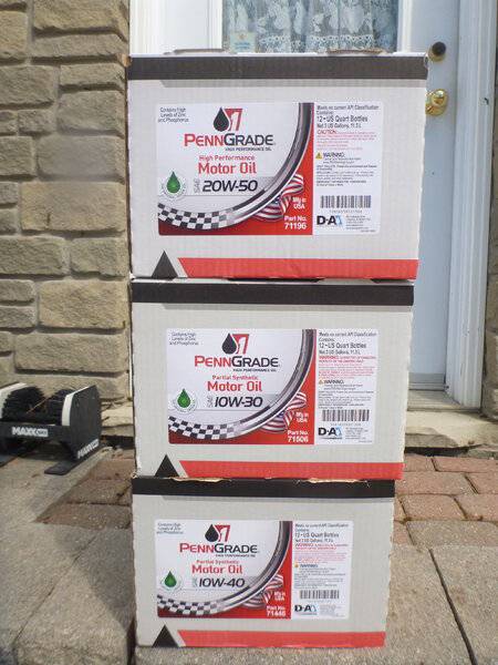

The last article I read with actual lab test data showed ZDDP levels varied quite a bit with the "high zinc" oils. I've run Valvoline VR1, Lucas Racing Only, and Brad Penn/Penn Grade with my solid flat tappet cams during the last ten years. They all seem fine. Though IIRC the lab tests showed a variety of ZDDP levels for each of those.

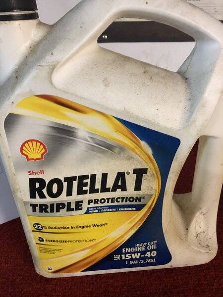

I’ve got 7qts of Rotella-T 15w40 that I’ve stashed. It’s going into my 440. From what I’ve read, adding zinc additives can screw up the original chemistry put in the oil. Go for something good and be done with it. Also,I can remember doing cam replacements at the dealer and there was no 2500rpm break-in. Put it in and drive away. Course this was stock valve springs,etc.
