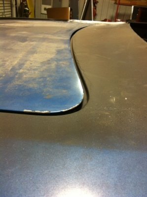

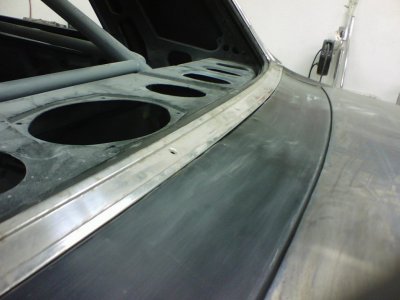

Usually it's only the window lip area that's rusted. It's a pretty easy patch panel to make with a shrinker-stretcher. I made the entire bottom window lip for my 64 Belvedere. It was the 2nd parch panel I ever made. Came out fine.
Doug
B153.jpg View attachment 380979
That looks really good Doug. I don't have any metal forming tools, or the knowledge of how to use them. But I guess I may have to learn because I don't think anyone is going to reproduce it. By the way, I have a 64 Belvedere too. It's next on the resto list. :thumbsup:

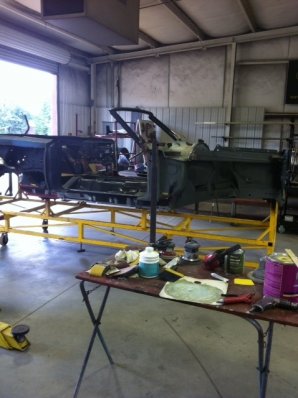

To bad they did not have it. AMD did a complete restoration on my GTX at their installation shop in Georgia and built some of the frame parts.

The shrinker/ stretcher is isn't too expensive, $139 at harbor frieght. I bent the L shape between two 2x4. Then put the curve in it with the shrinker/stretcher. First tIme metal forming. You have to start somewhere. Mine needed the entire bottom of the window lip.
Doug
