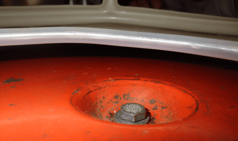

I was looking at the Promax air cleaner and noticed what appears to be an angle to the base where it meets the carb.
Yep, that's why I asked if the OEM base does the same thing. Looks like it does in some photos.
