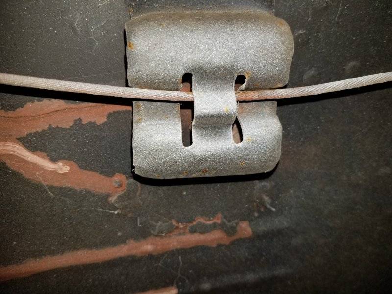

Does this E brake cable bracket look right?
Speedbird

I remember welding it to the new floor piece using the old drivers floor as a template and feel sure I got it in the correct place.
Now I'm looking at it and noticing it angles through the bracket instead of going straight through the bracket.
Maybe someone can look under their car and confirm if it is supposed to be like that?
The cable comes from more outboard forward of the bracket and I think it goes more outboard to the rear of the bracket too, so I can't see how it could be any different for a straight shot instead.

It sure looks like it could wear (worse) over time like that.
If that is the case, I may try a nylon or similar bushing.
It appears to be 1/8 cable.
I put a bit of rubber hose in mine but was not entirely successful. I thought about a plastic bush but ruled it out sometimes you can cause the cable to fray.
Grease it up and you should be OK metal on metal can work for years with no issues.
