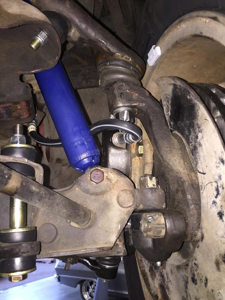

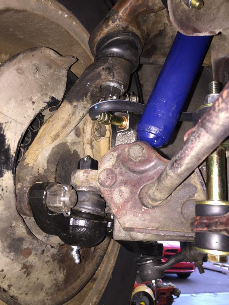

Hi all,
Currently rebuilding my 71 Charger and have a quick question.
Did I install the brake line correctly? It looks a little strange and seems to put a lot of stress on the line there. Any advice would help. Thanks again
You need lines with a banjo type fittings that attach to the caliper.
Not good...................something AIN'T RIGHT.
I looked up the hose on the computer and it's correct going by a picture, couldn't you swap the spindles and have the caliper in the front and the hose would be a straight shot to the caliper? the car doesn't care if calipers in front or back.
Russ
Looks like a drum brake line on a disc brake assembly.
For '71-74 B-bodies, the spindles & calipers are on the wrong side of the car, calipers should be on the front, lines straight out towards the rear.
Wow thank for the responses, this helps alot! Thanks guys!
