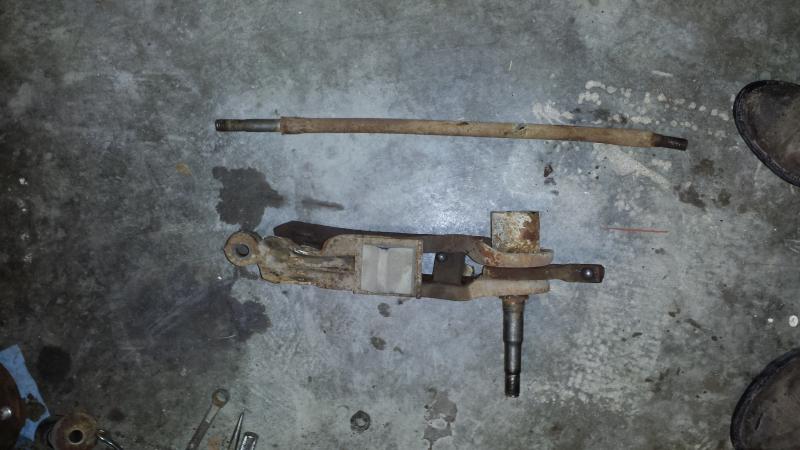

I'm fixing my worn out suspension on my 69 Coronet and ran across what looks to me as some bent parts. Now I know the strut rod is no good, but the lower control arm I'm not sure about. Does it look bent? or is the shape of it normal?
Both look bent to me. Looking at the strut rod, I would imagine the damage would have stemmed from a badly damaged LCA, like you have there.
looks like the Passenger side took a hit. it is nearly Impossible to align that later. I would look for a new lower and bar.
Yeah it's bent mate..Get new parts...Even attempting to fix this is a waste of your time.
Might want to buy a set of oversized strut rods. Not the adjustable, just oversized.
