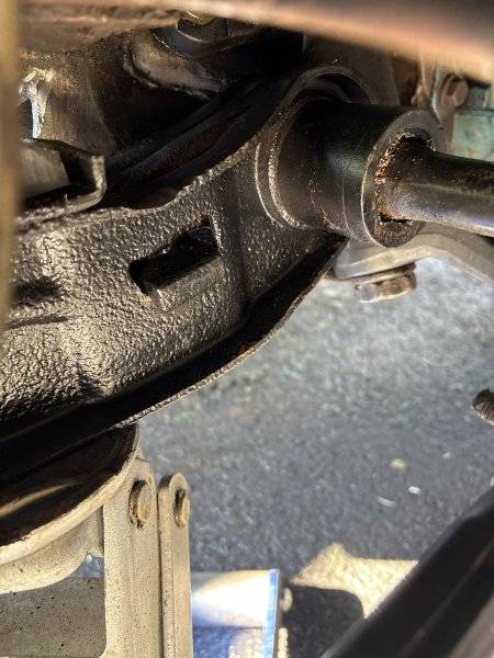

Why do you need to pull the t-bar ??? Just let the LCA drop down and the nut will come out. From the looks of all the crud it may need a tap with a hammer but that should do it. No need to pull the t-bar.
And the ONLY way a t-bar can go in wrong is if its on the wrong side. Front to back doersn't matter. They are stamped L and R on the ends.
