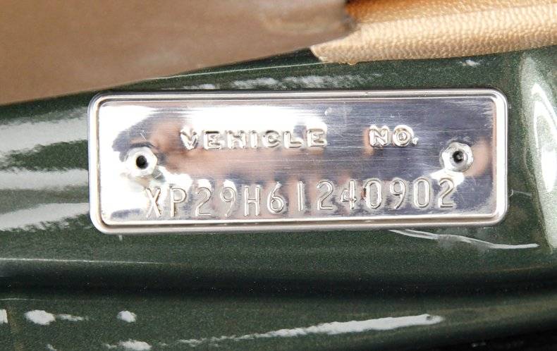

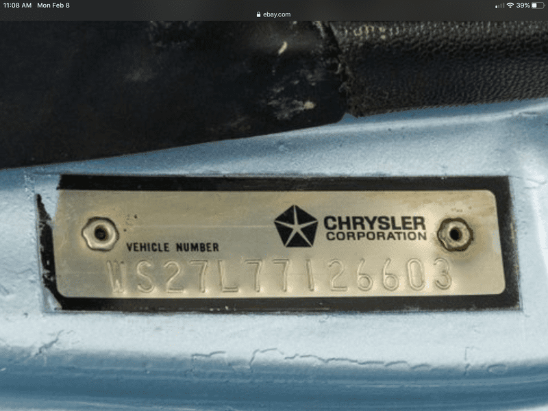

A 1966 VIN tag should not be identical to a 1967. They are very different and it doesn’t matter the build date or plant.
66 has a stamped rib around the outside edge and stamped in “vehicle no”
67 is all flat with a black border and says Chrysler Corporation, vehicle number and the pentastar in black.
