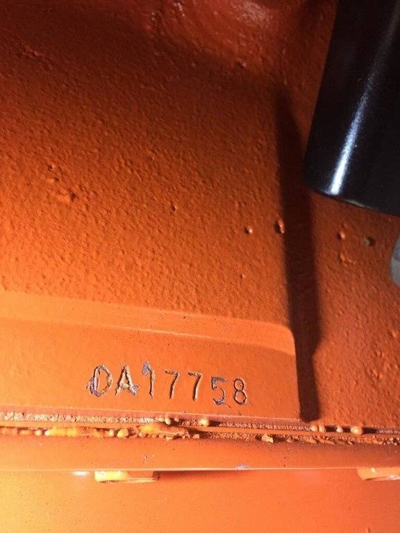

Hello, this engine vin stamp is on a 440 and said to be NOM to the 1970 superbird that it is installed in. The stamp matches the VIN but it just doesn't appear to be right. The 0 doesn't look like any 0 I have seen on an engine before. Looking for any insight. Thank you. The last number appears to be there but it is very light. I know that is not unusual.

All 8 digits are there. The last number is a 7 and is just very light. Not uncommon. It is easier to see in person. The picture doesn't show it well. My concern is the font of the stamp and how rough the edges look. The 0 at the beginning looks really rough.

Sorry I wasn't thinking right. It is supposed to be matching numbers. The number on the block matches the VIN. The build date is Nov 30 but I'm not sure of the casting date. I'm not near the car anymore.

Looks 100% fake to me. Missing a number. Just my 2 cents.

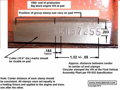

My initial reaction is fake. The "0,1,5" look different (see MMC photo attached).
However, I would chemically strip the paint there to see if the leg on the 1 is filled in. I see the outline of the last 7. The 0 could possibly have a beat-up edge but the curve looks wrong. You could then also verify the look of the stamp pad milling marks.

Some warranty blocks were stamped with VIN by the dealer, I wouldn't expect those fonts to look like factory.

That' not a 69 vin in picture is it? looks like a 71 to me.
I thought a 1 was made into the 0 at first too, maybe the poser didn't have a 0 template. I was thinking the space between the 1 and A might be too large, but it sure looks like it was a wrong-font 1.

Thanks for the replies. Definitely confirms my suspicions. Unfortunately this is a car that a friend went to look at to buy and he sent me that picture after he left. He didn't look at the ID pad or the casting date. The car had a few issues anyway and he didn't buy it. The vin does match up with the registry and the transmission stamp was matching and definitely correct so I believe it's a real bird.

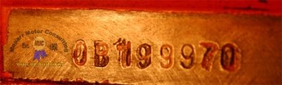

For what it is worth, here is the engine stamping from my 1970 Road Runner, built October of 1969. It is a 383 engine, so there could be differences. I am not an expert on engine stampings, but I offer this shot as a reference picture for what I believe to be an original Chrysler stamping in that time span.

The paint is masking a lot, but the stamps are the correct fonts (compare the 7 and 8 with the pics in post #9, for example).
That pad needs to be stripped to get a better view though it looks pretty legit to me.
