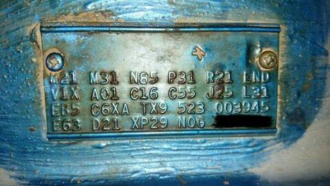

This Charger VIN stamping is better than mine.Does that mean that they are like the the ones on this Charger?
That's a great looking tag Wayne..... and to me is 100% legit. Also noted the SPD is only 4 days before my ex-GTX at the St Louis plant.The car in the OP is absolutely drop-dead gorgeous and all the more stunningly beautiful without the optional front bumperettes. The bumperettes are a personal opinion kind of thing you know.
I like everything about the dash VIN plate on this Charger. I've been critical of other dash VIN plates posted to the NOT MINE cars for sale threads. I haven't changed my mind about one in particular @kiwigtx
If we wanted to get really picky about something on the OP car, then we could say a couple of things about the fender tag screws and the smooth paint (no rag marks) around the fender tag itself. Mine for comparison is below:

Appreciate the input!I would think someone trying to fake a VIN stamp would be prone to making it too perfect
