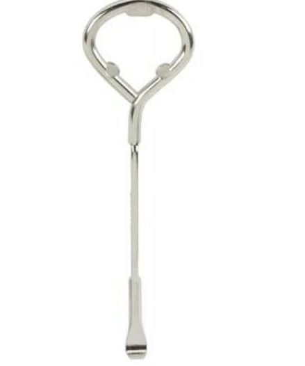

What I ended up doing was using a paint can lid tool, available all over the place for around $5. I put some masking tape on the curved end of the tool to protect the wheel and cap when I pry. Works like a charm!

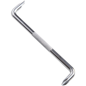

I have these Craftsman zig zag screw drivers. I just put the flat behind the cap and pull on the other end. Never touches the wheel.

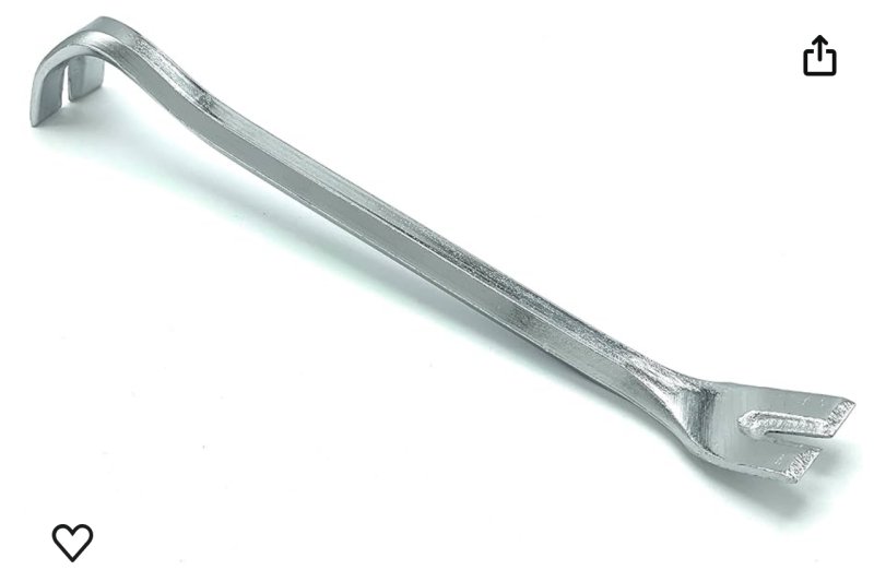

I used a mini crowbar like this to remove dog dishes. I wrapped tape around all but the very end to prevent paint chipping.
