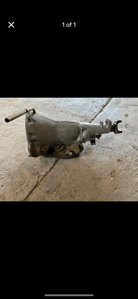

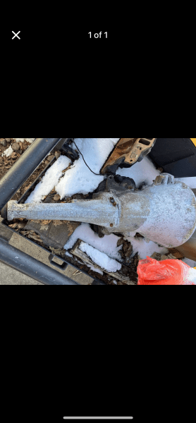

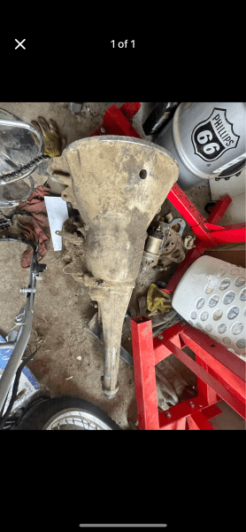

Thank you all for the responses. Just to clarify. The long tail housing lengths, such as the 2 in the photos, are what I want, instead of the one with the short tail housing length with the bolt on yoke.
Thanks again
You don't want the bolt on yoke. Then you would need a 2 piece driveshaft that has slip joint in it.
Going to a 727 from a 904 you're going to need to change the slip yoke anyway because they are not the same size.
Just get a long shaft 727 transmission and grab the driveshaft from it as well. You're definitely going to need a shortened driveshaft.
Do the research of how to properly measure the correct length you'll be needing once you get the engine and transmission in the car.
Tom
Any driveshaft shop can fix you up with what you will need for a yoke or new driveshaft. Some shops prefer to make you a new one vs shortening an old one.
