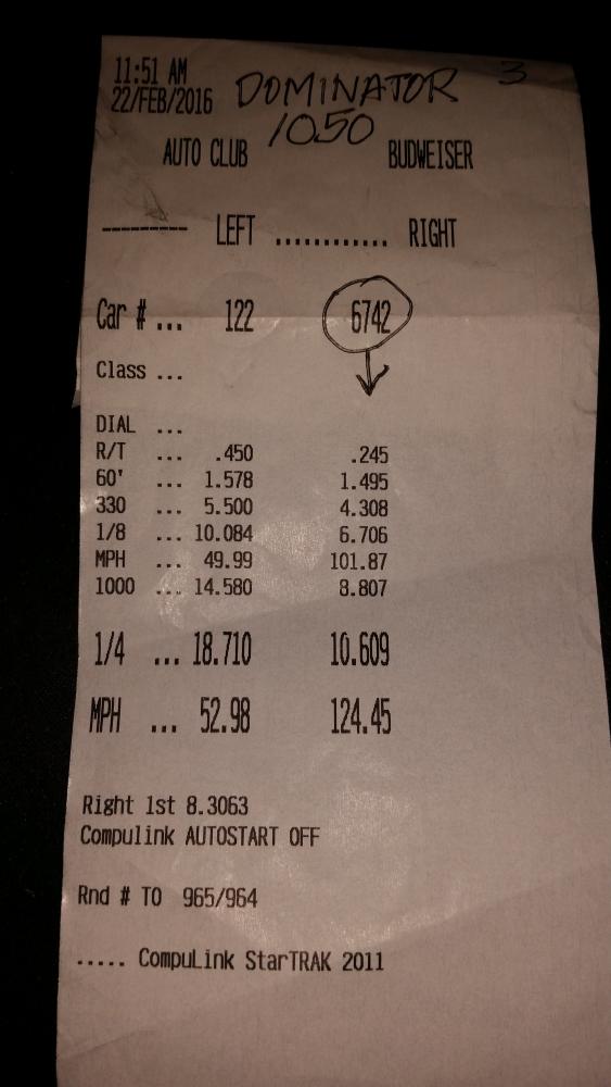

My Test&Tune at Famoso went well this last weekend.
I went personal best 10.609 @ 124.45 with a 1.479 60'

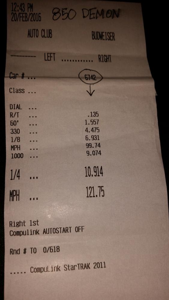

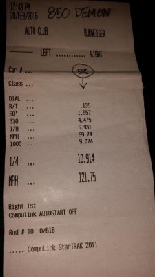

My best run with the INDY Dual Plane had been 10.989. I installed the Edelbrock Victor 440 Single Plane (no other changes, same 850 Demon and Wilson Spacer) and went 10.914. A .075 (3/4 of a tenth better ET from the manifold change.)
Then I took off the 850 Demon and Wilson Spacer and bolted on my TransDapt 4500 to 4150 carburetor adapter to fit my new 1050 DOMINATOR onto my Edelbrock Victor 440 Single Plane.
RUN WITH 850 DEMON:
10.914
FIRST RUN WITH DOMINATOR:
10.609 @ 124.45

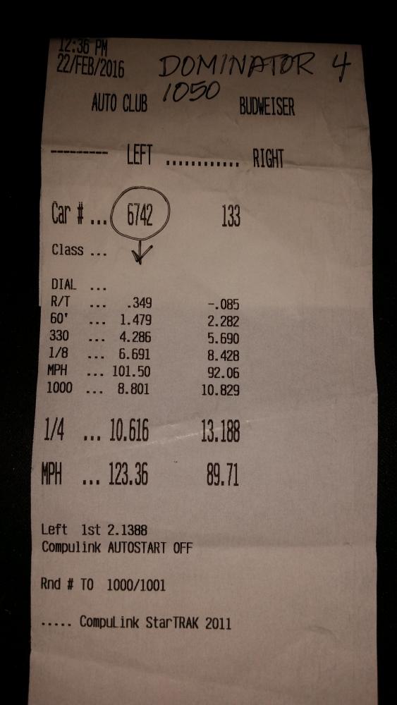

SECOND RUN WITH DOMINATOR:
10.616

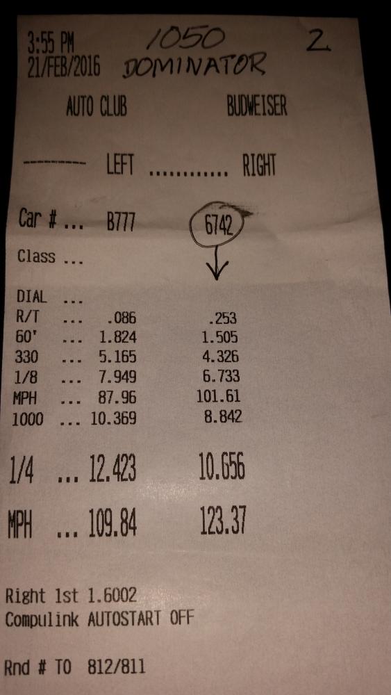

THIRD RUN WITH DOMINATOR:
10.656

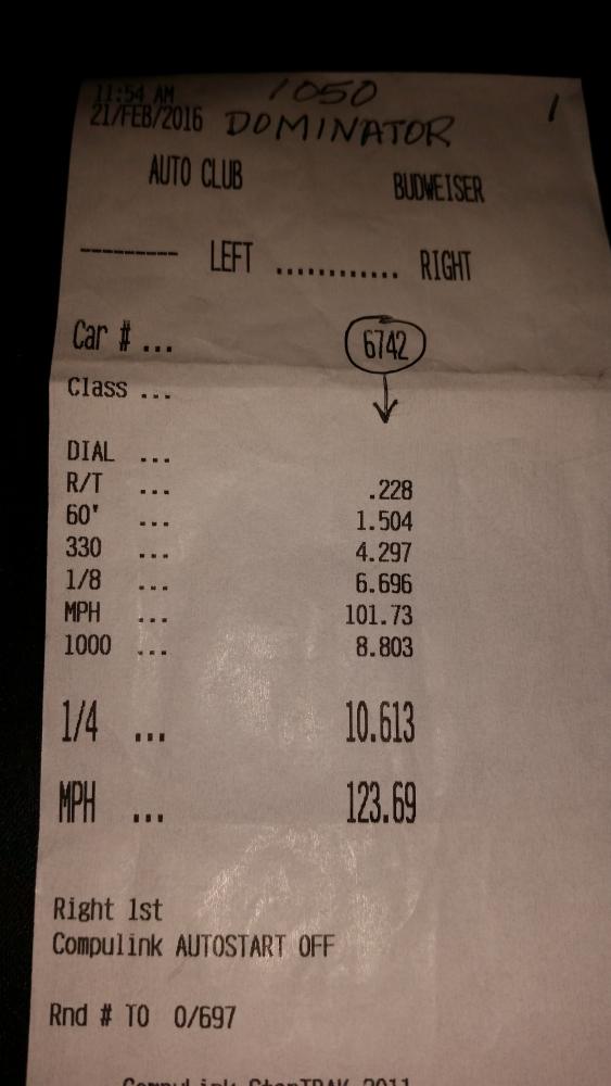

FOURTH RUN WITH DOMINATOR:
10.613
FOUR RUNS WITH THE DOMINATOR WITHIN .047 OF EACH OTHER.
The Dominator was "Out of the Box" with NO changes...just bolted it on.

I could NOT believe the carb change gave me 3/10th of a second lower ET.
A 3/10th of a second increase with only the Dominator change. I am a believer when guys say that 500" big block Mopars want MORE AIR.
