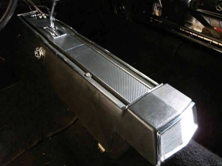

Can someone please post a pic of the rear part of the console on a 66 Belvedere or Satellite. I know I'm missing some parts but I'm not sure what all is supposed to be there. I tried to post a pic of mine but so far have been unable to figure out how to do that.

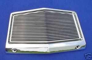

This is the console end trim plate:
You can buy it reproduction these days, or still find used.

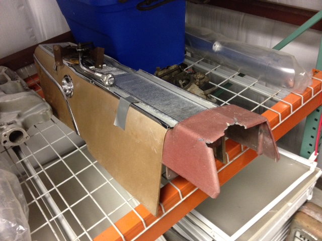

Guys, thank you so much for the replies. With your help I was able to get the image posted. As you can see I'm trying to piece this console together with parts from different sources. What am I missing? Although you can't see it in the pic, I do have the chrome piece that sits on top at the front of the broken piece. I'm really puzzled at the big missing area at the rear bottom?
