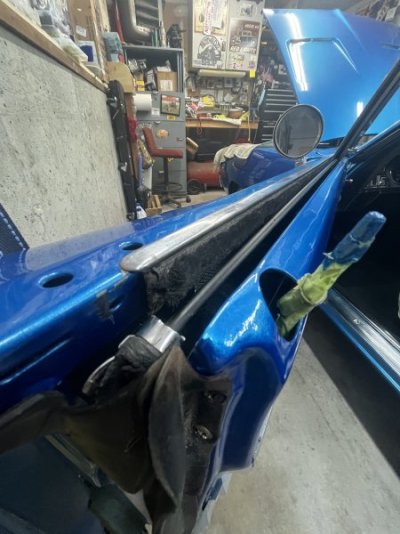

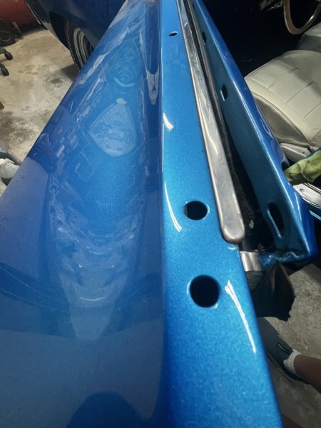

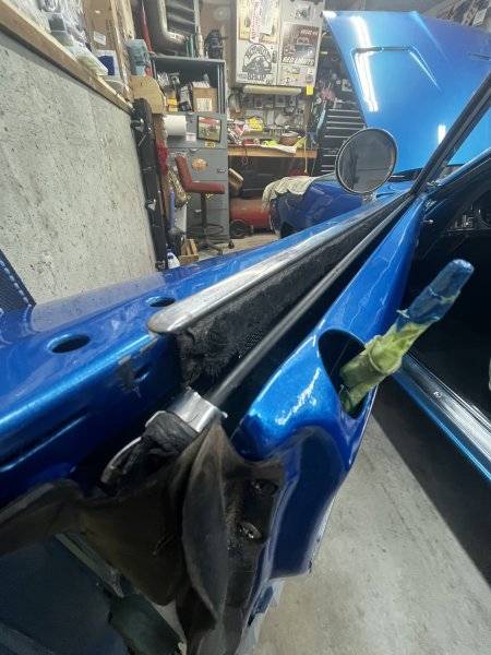

my 68 Charger has outside chrome trims with felt, which touches the door glass going up and down. Is there also supposed to be “inner felts/trim on inside of the glass? If so, what are they called and where to get?

I did see those, but I’m not sure. Since my “outer” felts have a chrome trim, i thought maybe the inners would have the same?
I need to find a picture of a car with everything on it to see what I’m missing
First of all, the outers are not felt - they are rubber - like squeegees - and yes, they contact the glass to minimize what gets down into the doors. The inners are felts.
Whether they have chrome or not will depend on your make/model - mayube even the manufacturer.
They should all come together in a "catwhiskers" kit.

As mentioned, i have a 68 charger…my “outers” are not rubber, they “feel like felt”… i will search for “cat whiskers “
Short, soft bristle material as used on the inside is often sold for the outer trim instead of rubber. But I believe OEM was rubber. I wouldn’t worry about changing them unless the car will be out in the weather a lot or being judged at shows.
