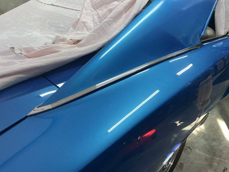

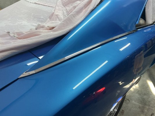

When installing the chrome trim around the rear sail area for 68 Charger including out and around onto top of fender, what clips are used?

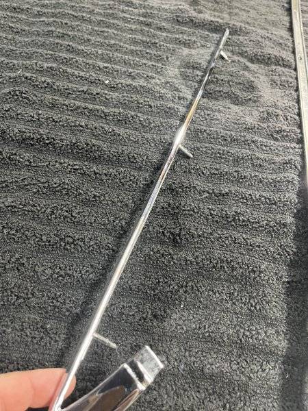

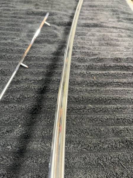

The “inside sail trim” has studs , the outside trim looks like needs “slide in” clips?
The inside pot metal trim with the studs use thread cutter nuts. The long outside stainless trim uses slide in clips. The clips that have the studs go towards the rear because they are accessable to get nuts on to. The three holes towards the quarter windows get the push in clips because you can't really get behind there to install nuts.

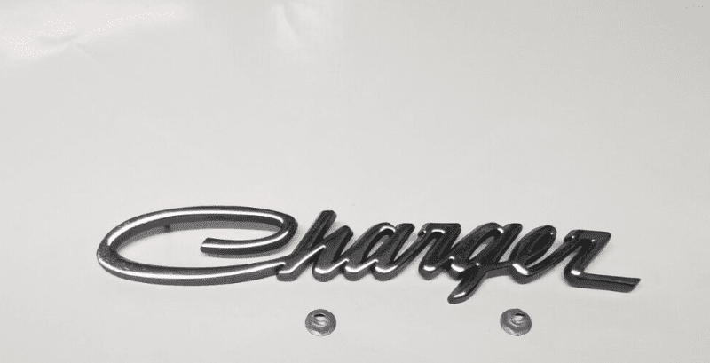

The “Charger” emblems on outside of sails upper qrtr panels, what to they take for fastening?

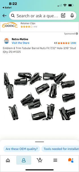

Those take the thread cutter nuts as well. If your headliner is already installed it makes it a pain to install. Some guys say that you can get to them from the trunk and others end up gluing the emblems on or using barrel nuts
Oh boy, yup, brand new headliner is in….
So either 3M tape, or are you referring to this style barrel nut?IMG_7644.png

It took a bit of pressure to start the nut on the emblem stud.
I was able to hold the emblem while push/twisting the nut on with a socket.
Also the sail panel cardboard piece with block your access if already installed if I’m remembering correctly.
If they are new emblems you can run the nut up the stud with the emblem in your hands just to establish the threads. That way you don't have to try and kill the nut to make new threads in an awkward position.
