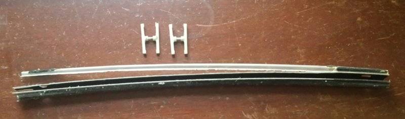

Here are the pins I have, don't think the plastic strip is useable
Thanks I have those ^^
I'm referring to the lock side channel as 69bfan mentioned (not sure if OP is as well)
Right, the bottom piece is the lock side channel, I thought someone asked for a photo.
The lockside channel is the metal bracket with the flocked extrusion that is positioned at the back of the door frame that the door glass slides up and down in. If you should look into the cavity of the door, it will be the channel closest to the door latch and door handle mechanism. Now that I think about it, the post/sedan lockside channel does not include the nylon insert. The mylar liner and H pins as posted in post #14 is located on the front side of the door glass and fits into the vent window frame channel.
