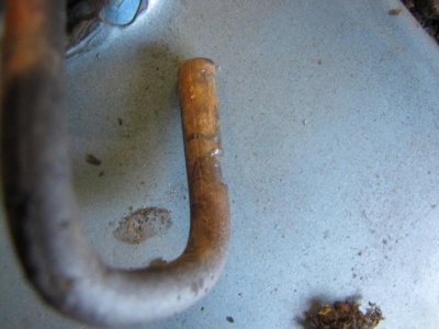

Has anyone got a pic of their lower, driver side door hinge? I'm rebuilding mine and I've seen pics with the spring in different ways. On some pics the curved end is on the top but I've seen a few with the curved end on the bottom.

That's because there is no lower left or right side specific door hinge, they're identical. One side is flipped vs. the other, thus a curved spring up top on one side, flat sided on the other.
