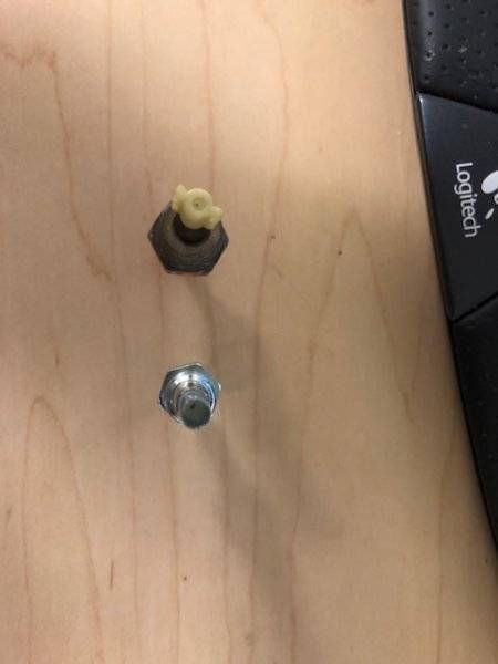

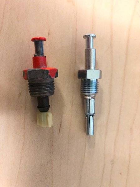

Hi All. I have a 70 Roadrunner and the drives side door jamb switch isn' working. I ordered a replacement part and the new part is a 3/8" thread where mine appears to be 1/2". All the sights show a 3/8" thread. Could mine have been altered? And if so, anyone have an idea of the switch I need to get based on the picture. Thanks for the help.

Don't know what that switch with red paint came off of originally, but all I've seen are 3/8" 1-pin.

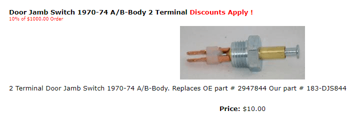

You need this part from MegaParts....
https://www.megapartsusa.com/proddetail.asp?prod=183-DJS844
I was helped out here by @moparnation74 with the same problem :)
:welcome:
kiwigtx, wanted to say thanks again. Switch works great. Thanks again for the help.
