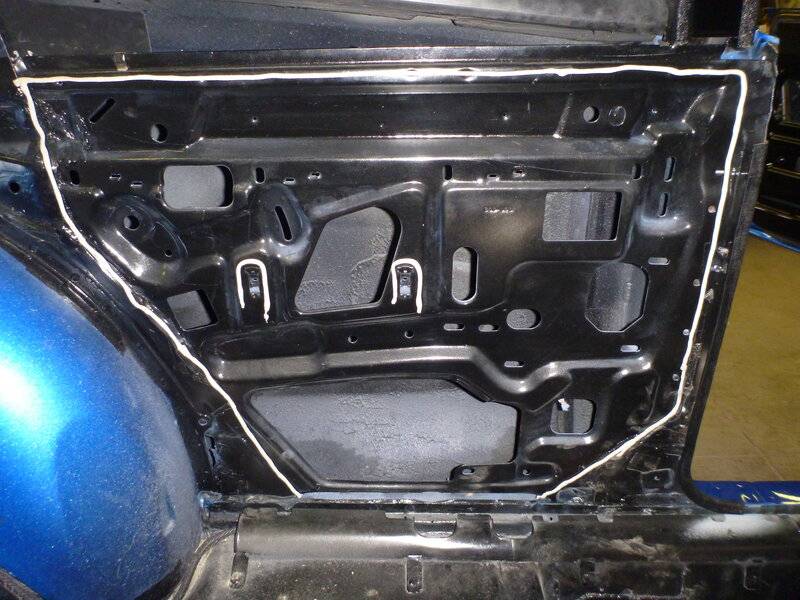

Just Wondering What You Guys Used To Attach The Poly Plastic To The Door Stucture To Protect The Door Panels?

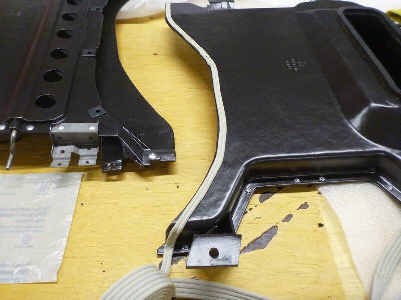

I use 3M black strip caulk. The last set of water shields I bought they included a bunch of gray strip caulking very similar to 3M strip caulk, but maybe a little softer - so I went ahead and used it.
Draft seal, from your local Ace hardware... door vapour barriers and ramcharger airboxes...
