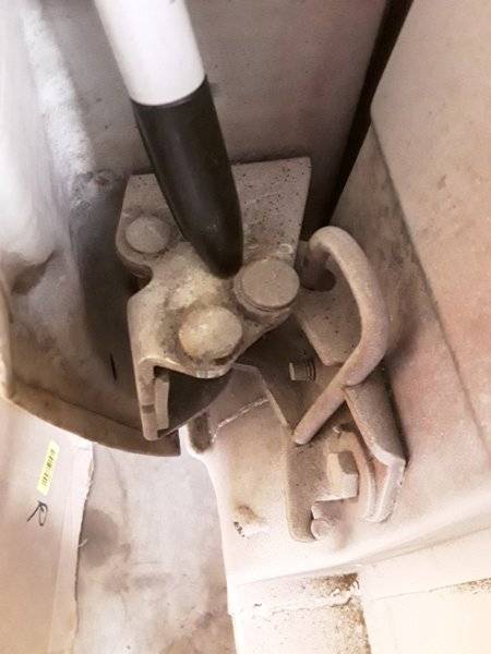

What do you call the notched/ribbed washers that the door springs roll against ?
Who sells them ?
How do you replace them, the stud they are on is pinned/smashed on the bottom so it looks like you can not just unscrew the studs and swap them out?

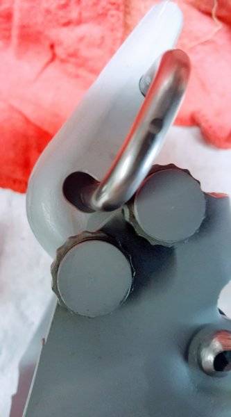

Restoricks has the parts needed to repair them.
They are called detent rollers.

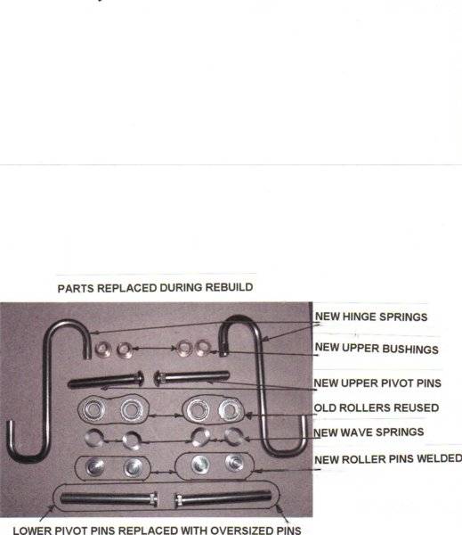

You grind the back of the stud flush to remove the old one and the new one is welded in place instead of riveted. Will most likely have to removed the hinge
to perform the repair.
Yep. Called door checks. Part of my hinge rebuild process. Not sold separately. the hard part is not the rollers, it is the pin that the rollers ride on and attach to the hinge. Custom made. Also will need to get the wave spring that goes between the roller and pin. This is what I do. For over 20 years now. Many happy members. Write up in August Mopar Muscle magazine. I did the editors car, a 64 Plymouth Savoy. Future project car.
