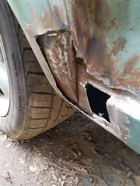

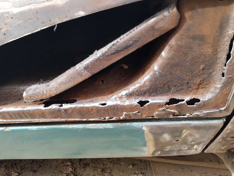

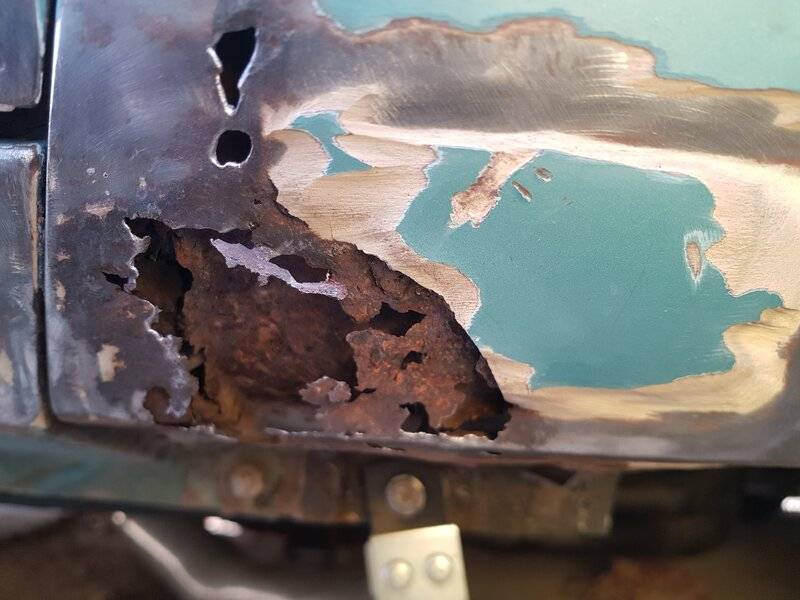

And some rust pictures for interest:)

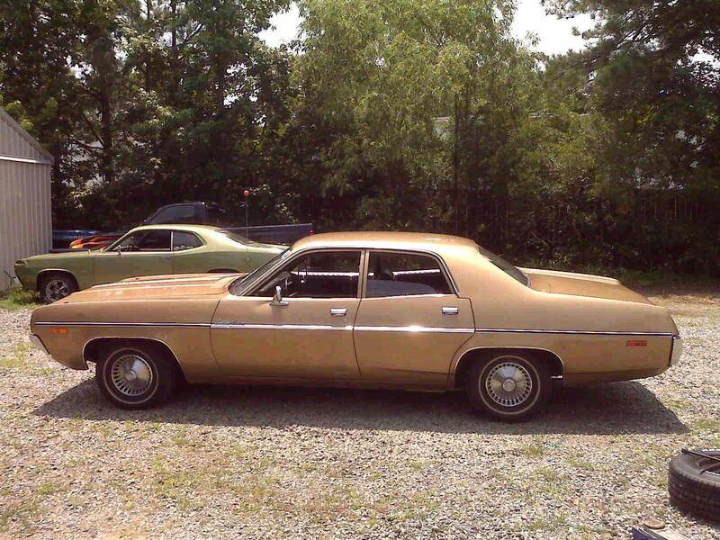

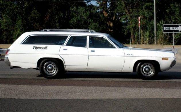

Nope.
Sedan rear doors are rounded at the top rear.
Wagon doors are squared.
Seals and windows are different, too.
Technically, it's a separate part that's different- the window frame but they're put together pretty good.
I've never tried to get them apart. I imagine they are welded before the skin is put on.

When they redesigned the wagon uni-body in 71, they started using sedan doors.
WRONG!! 4dr and Wagon doors continued to be different.
As before, the 4dr door is rounded in the upper corner. Wagon is squared off.
I have a window from a 4dr. If you'd like, I can lay it on my wagon's door and show you the huge difference.
