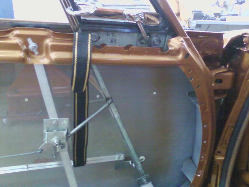

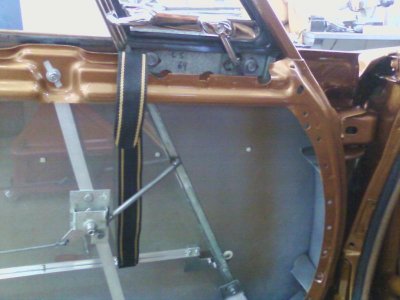

Sounds like new weather strips. If the door already fits well try the striker 1st. If that doesn't help get a dollar bill and shut it in between the door at various points to see where the weatherstrip and door are too tight. You can then pull the strip loose from the flange (just pushes on). Take a adjustable wrench and close the jaws tightly on the flange. Bend it inward, reinstall the strip. Do this in the tight areas. Sometimes you may even have to wack the flange with a block of wood and a hammer. When I painted my 64 one area was so tight from the factory at the belt line oft the door that i cut out a section and rewelded it. My doors are completely gutted on the inside so they have become flexible. They still were able to be fitted to open and shut great with new weather strips.
