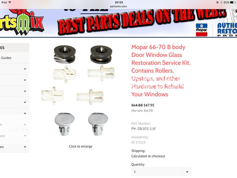

With this kit to replace the door window bits
i understand the right side white plastic parts are the rivets that hold the glass to the lifter
the black wheel is the roller that goes in the lifter bar
what and where do the other white plastic bits that are on the left go?
where does the metal thing go?
The left side white plastic pieces are the up stops and the metal pieces are the pins for the new rollers. The up stop fits in the hole at the back lower corner of window glass and the metal pins are attached to the regulator arm by Bradding them in
Thank you. What does Bradding mean?
i may have spelled or described it incorrectly but in short you stick the new pin in the hole and mushroom out the end to hold it in the regulator.
Maybe the better word would be swage lol
Lol ok I get what you mean. How would you do that in such a small space?
