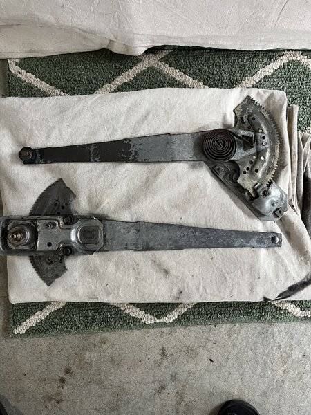

How do I determine which regulator is driver side and which is passenger side? When I removed them I didn’t realize they were different. The only number I can find is EM 47 on one, but haven’t been able to find out anyplace.
The coil spring is there to help lift the glass, when the window is rolled down the spring will be under more tension.
There is also a stop pin, pressed into the bracket & in the opposite position, side to side.
Top one is left, bottom one is right.
