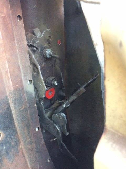

Help !! I'm totally screwed. Can't get the drivers door to open on my 71 Satty.
I've got the door panel off and can see the linkage, and all rods. The lock/unlock appears to work - it appears to travel. The door handle moves the link rod and i can see the latch mechanisms moving. I can even reach in with a long rod and confirm things are moving to their full amount.
So,.... what can i do ? I thinking i'd have to remove the window and regulator, cut an opening in the panel big enough to get to the backside of the latch and start destroying it -grind, torch, whatever to get it free from the door.
Anyone have any suggestions ? I don't even think i can get the regulator out without having the door open ?

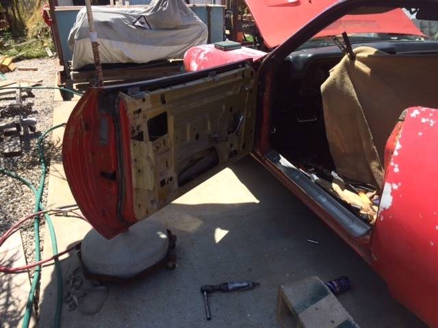

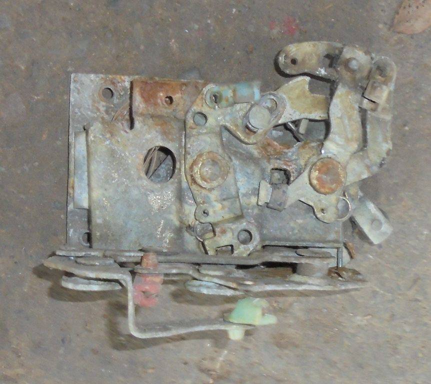

Bought another latch from a member here, (thanks 68 Charger) to see if there was anything i could glean by having one in my damn hand.... NOPE. ....and to have when i butchered my existing one :)

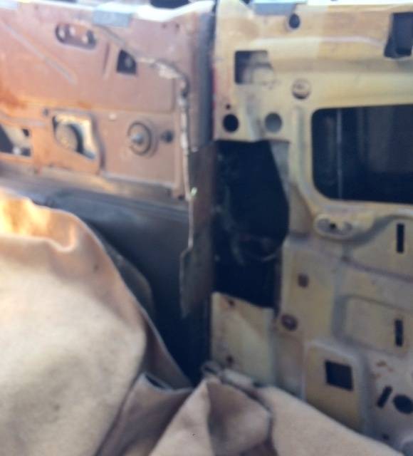

Opened up the door shell enough to get in there with a die-grinder (two types) and started taking it apart bit by bit until in could pry it apart and swing the catch off the striker. Didn't take long once in started, maybe 30 minutes to have the door open.
(thanks 68 Charger)
Opened up the door shell enough to get in there with a die-grinder...............
You're Welcome. :thumbsup:
Damn that thing kicked your A$$. Glad you finally got it opened.
I know right! I'm a good butcher though. LOL

I hate to say it, but cutting the door was not necessary. I'd have removed the door and taken it to a local mechanic.
