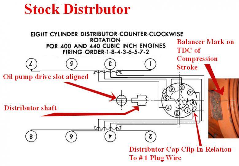

a trick I recall to know when it's getting close to TDC on cylinder #1 is to follow the #1 spark plug wire back to the distributor cap noting where the #1 position is on the distributor. then, remove the cap, so you can see the direction the rotor is pointing, and turn the engine by hand until the rotor is nearing that #1 position.
Both valves will be closed on #1 at TDC .
