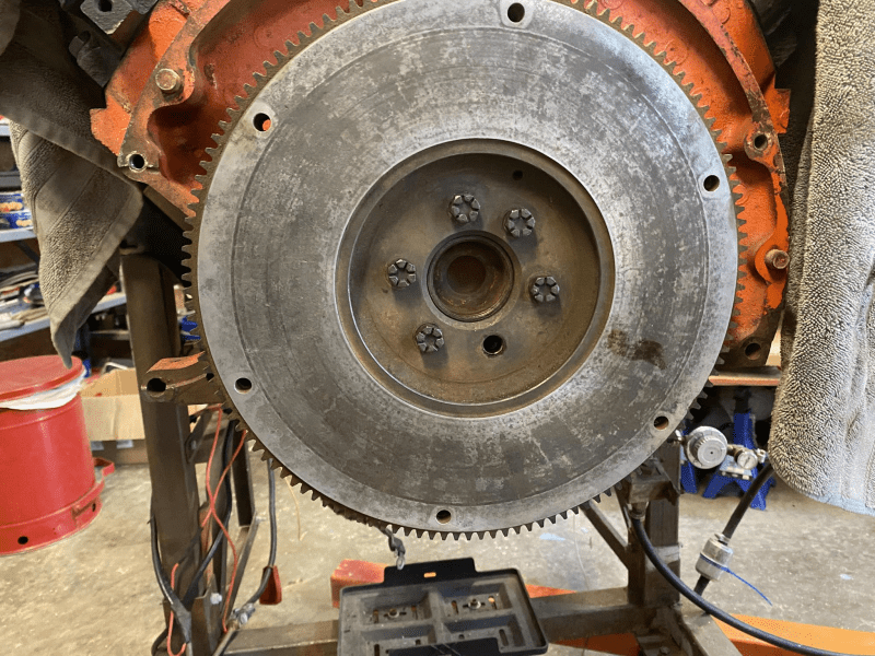

You could buy one. What do you have now? Post a picture of it both sides.
OK, I'll get a picutre of the backside, but can you tell from this if its neutral or externally balanced?

No. Your crank wont allow the input shaft to go in to the correct depth. You either need to have the crank drilled or modify the input shaft and use a special pilot bearing.

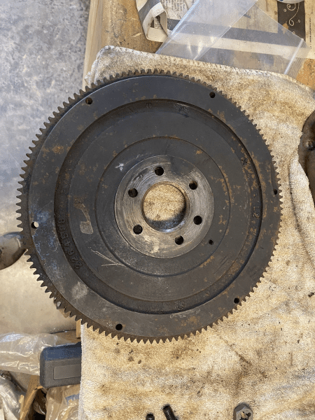

He has newer external balanced internals. If he shows the other side of his flywheel that will tell the story.
Here is the other side. So this looks to be neutral balance and I need externally balanced?

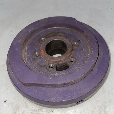

Another question/point of clarification; regarding the harmonic balancer on the front; how can I tell if its externally balanced? The one I have is the balancer that came with the donor engine, so I have no reason to believe its not the correct balancer for the crank but just curious.
Ended up modifying my neutral balance flywheel to make it externally balanced so its compatible with the cast crank. Shout out to brewers performance for sharing the spec sheet with me. Here is a link to a video I made of the process. Also here is a link to the specs:
