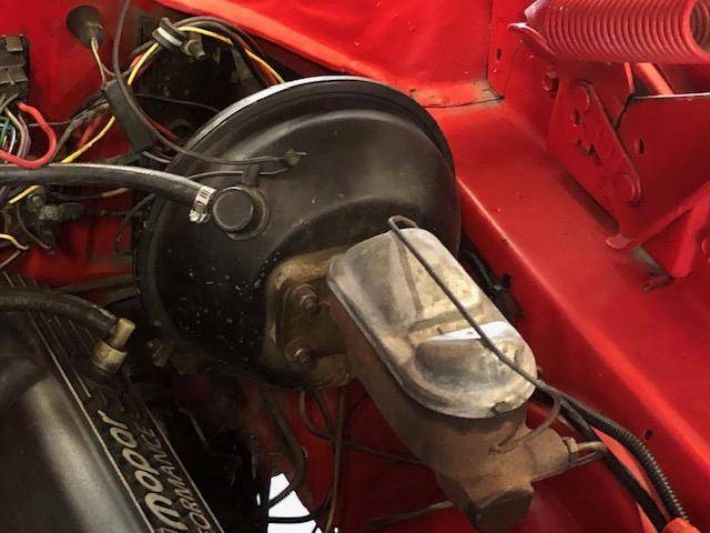

I have had the ubiquitous 12" Cordoba rotors (Actually 11.75) on 75 Dart knuckles with single piston iron calipers with a 2.75" bore pushing carbon metallic pads. It stops okay but not fantastic like some stock front disc-rear drum A body cars that I have had.
I want to change to a NON power master cylinder at the same time. I have been using this bulky booster and master cylinder for over 20 years now...

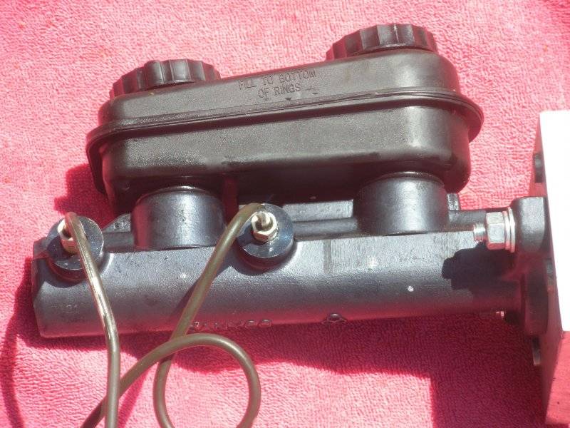

The Dr Diff master cylinder I want to use looks like this...
Aluminum, 15/16" bore and 2 bolt mount. It comes with a 4 to 2 bolt adapter plate.

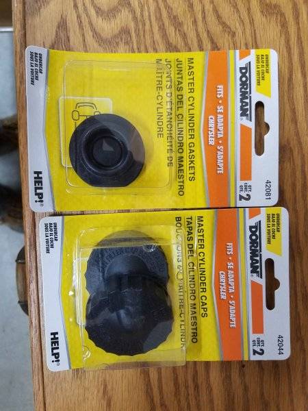

Observations - I bought this car with the above parts already installed. The looks are great. However, in my opinion, the car does not stop like it should. Car stops straight. Pedal is firm and high but it takes huge leg effort to slow down quickly. I'd be concerned if I had to do a panic stop.
First thing I had to do was to replace the M/C caps / cap seals - original ones did not seal properly. I checked the pedal ratio and found it to be 6:1. I had another pedal from a parts car which I modified to have a 7:1 ratio to increase line pressure. Not much change. In a conversation with Cass, he recommended that this system may need to be boosted either by a brake booster or by a hydro boost system. Since my engine has a "large" cam with not a lot of vacuum, hydro boost seems the best option for me.

These are what Cass told me to buy. They are the cheapest at Rock Auto if you can add them to another order. I have a 15/16" aluminum masters on all 3 of my cars, and they all leaked. Put these Dorman caps and seals on, and knock on wood, they have been fine.
Thanks for this @hunt2elk, I got both of those today and it was clear from just putting them on that they seal far better and tighter. The stock caps looked almost identical, but they were "sloppy" and the inside gasket "weak" I guess you could say. I had experienced some annoying minor leaking. I also did get clarification from Cass, for anyone else reading this, that "fill to the bottom of rings" on the side of the master means to fill the reservoirs right up to the bottom of the filler holes.
