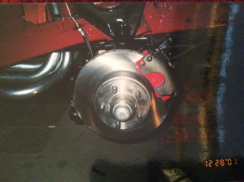

I just sold one to another member $30, I bought it thought a friend would like didn't work out. I did front disc conversion (with 11.75"rotors 15" rims or larger) that Mopar Action mag did in 2001 cost me $560. Mostly new parts except steering knuckles and caliper brackets. It was a hassle, junkyards here crush cars often. Shipping cost ??????
