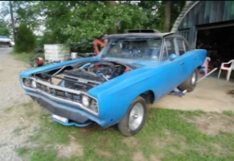

I want to turn this car into a drag and drive car along with doing local racing. It has headlights and tail lights already so i will need to add brake lights and turn signals. from what i have found from the original posts on FABO the builder did a best of 8.32 in the 1/8th with this current configuration. just need to figure out what class it fits into. 68 satellite 4 door 12 valve cummins, 727, dana 60 with 3.54 engine set back 16"
I'm pretty sure drag and drive events require working windshield wipers. Might be another problem to solve.
One of many reasons my junk won't be doing d and d.
If your firewall has been moved, you may find yourself in a very fast class.
That's why mine is about four seconds slow.
I know several that do hotrod drag week don't have wipers. I have to fix the rear main and injection pump leaks be fore i can get to a track and start doing hits. Also need to upgrade the brakes these work but not as well as I would like
