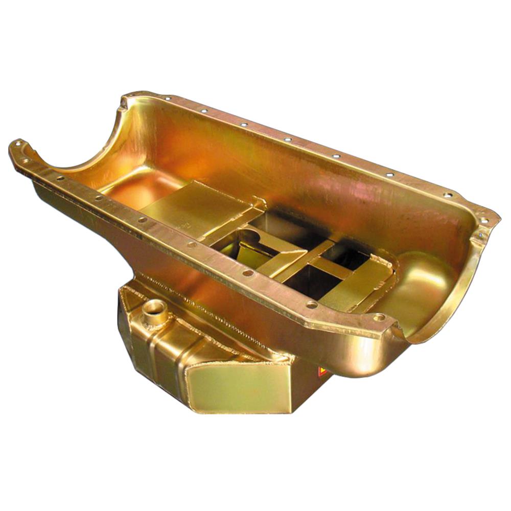

This is the one I run on my Blown 340. I cut the bottom off my 360 Challenger pan and welded a 1" band in between the two cut pieces. Then added a baffle. A little work but way cheaper.
