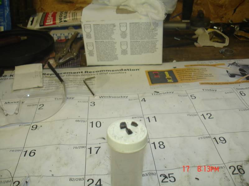

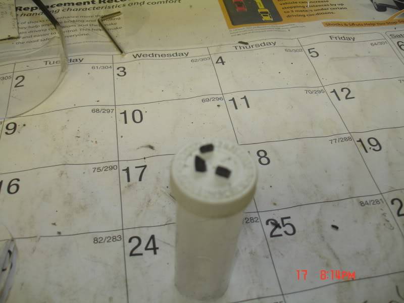

Well I was doing the last bits to the car,getting her ready for this season and saved my oil chage to last.Pulled my drain plug and found three pieces of metal to my magnet
Took a good look and wouldn't you know.They looked like timing gear teeth.

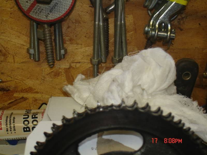

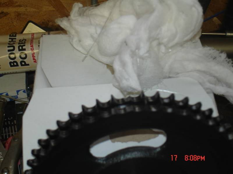

Pulled my timing chain cover and found this
Three teeth missing off the camshaft sprocket.All I can say thank god for magnets.She could have been a catastrophe.Down to my speed shop tomorrow and get a new set.

Without this turning into a product "bash";do you mind telling us what brand of chain/gears you've got? Any clue as to why these teeth broke?
Be VERY careful of what you replace it with,there are a lot of junk timing set's out there.
Without this turning into a product "bash";do you mind telling us what brand of chain/gears you've got? Any clue as to why these teeth broke?[/QUOTE
The timing set was by cloyes.My speed shop bud says that they are going to go good for it.So I am going to bump up to the next best product.billet timing gears instead of hardened steel.I'm just glad I found this.
