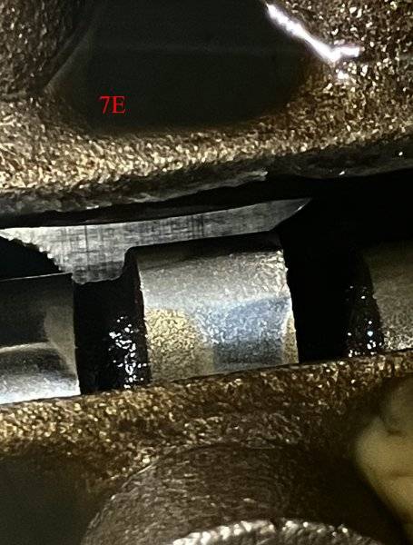

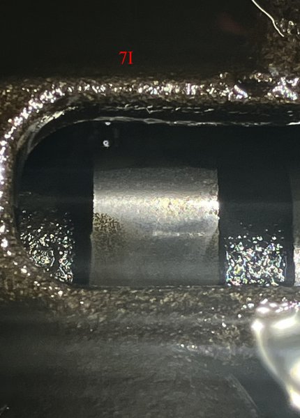

I did a little more measuring tonight but It's really a pain with the engine in the car. I had to stop befor I knocked a hole in the radiator turning the engine.
(Does anybody make a crank bolt with an extended hex?)

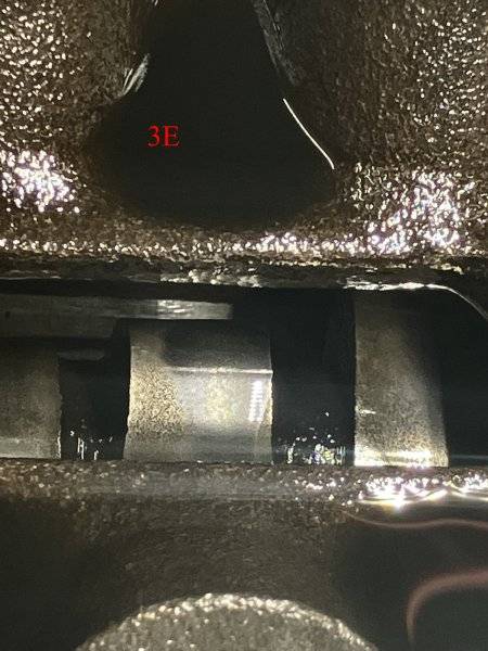

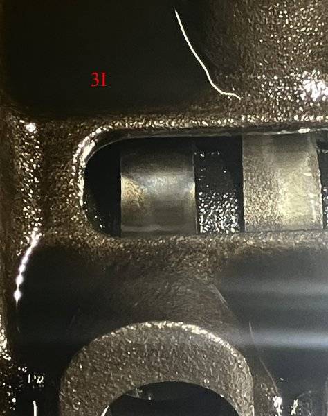

I also took pictures of all of the lobes at the nose.
Exhaust should be .356
Exhaust #3 measured .366 lobe lift, which doesn't make sense, maybe I counted wrong on the indicator. The wear looked ok
Exhaust #7 measured .353, but the wear over the nose looks excessive.
Overall 6 lobes looked like they have excessive wear over the nose.
View attachment 1833899View attachment 1833900View attachment 1833901View attachment 1833902

I don't know, they look okay to me. The areas that wear aren't showing grooves you see when the lifters aren't spinning. I'd be more concerned about what looks like some corrosion going on. Maybe too much zinc? The areas of the cam that don't wear are starting to look like the cast iron that it is.

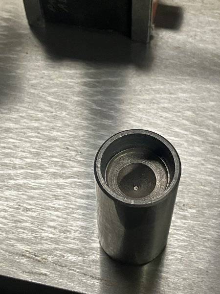

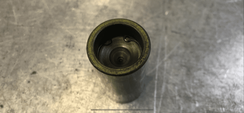

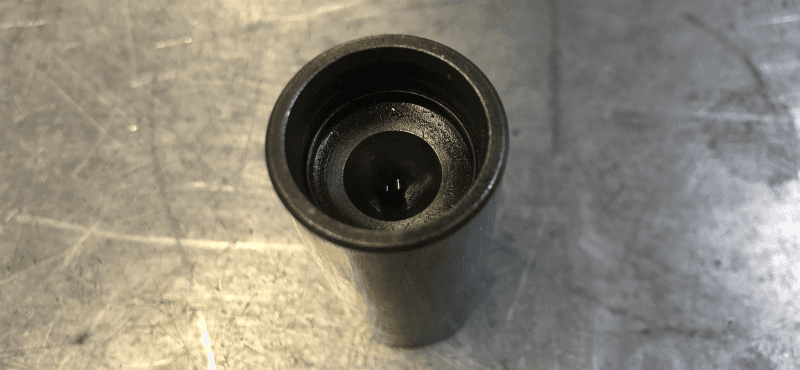

First pic……. Lifter I was running in my 383.
I’m pretty sure it’s a Comp 2921-16 from the very early 2000’s.
Second pic…… MP P2843177 from the mid-90’s

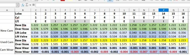

Cam Post-Mortem:
Below are the measurements from the Lunati Cam.
Note that some of the measurements on the base circle are bigger this time. I'm going to say its human error on my part, trying to find the proper spot to measure.
At any rate, the numbers in red are the problem, they pretty much coincide with the worn lifters, and the lobes that look the worst.
I'm going to say that I caught this at the right time, and it is in the initial stages of failure. How much longer it would last is anybody's guess.
