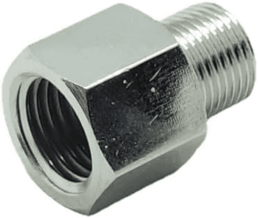

Does anyone make a drain petcock in M12 x 1.25 for my new aluminum radiator from Auto City Classic?
If not, can I drill and tap the M12 x 1.25 drain hole to the closest NPT for a brass drain petcock?
What about adding this..
https://www.amazon.com/CDQBWKJGFJ-N...-1-spons&sp_csd=d2lkZ2V0TmFtZT1zcF9hdGY&psc=1

I have the same radiator and used a 3/8 NPT reducer and a 1/4 drain.
