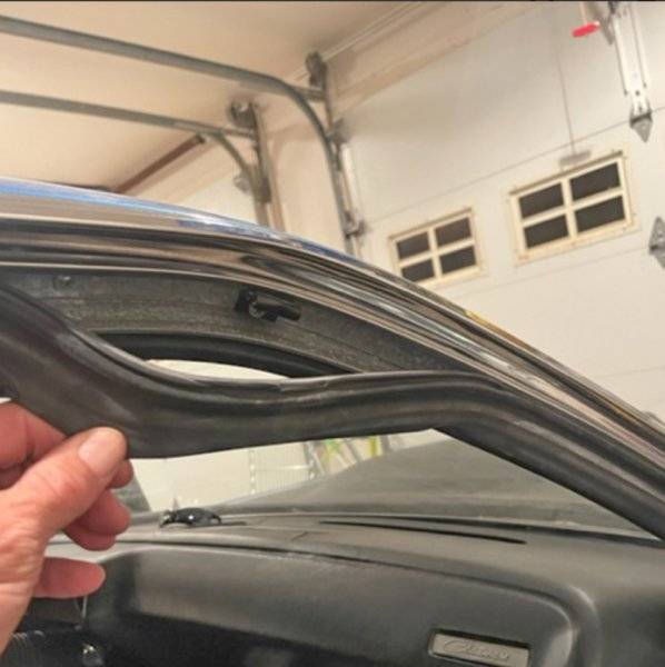

On a 71 B, looking at the manual, do I get this right that the drip rail goes on before the roof seal? Does the anti-rattle clip go on in between the two? Thanks!

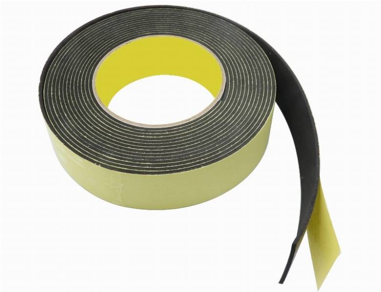

drip rail? I guess you meant the roof rail mold. It gets a foam sticked seal between mold and roof, attached to mold. yes, the anti rattle clip is between roof rail weatherstrip and mold
drip rail? I guess you meant the roof rail mold. It gets a foam sticked seal between mold and roof, attached to mold. yes, the anti rattle clip is between roof rail weatherstrip and moldView attachment 1442880
So you're saying the foam seal goes on, then the mold, anti-rattle clip, then the weatherstrip?
yeap, the foam seal goes between sheetmetal and mold, but attached/glued to mold, not to sheetmetal. Is a single side face foam tape
I see it now in the manual. Thanks Nacho!
