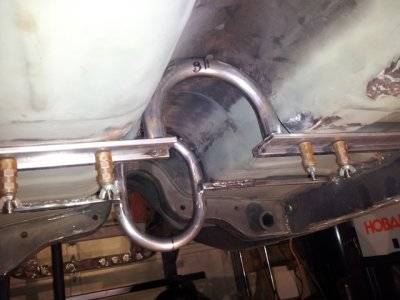

Did a custom loop on my car while I was doing the frame connectors and fabricating in the 5.7 tunnel hump . . .
The loop also is my connection from frame connector to frame connector so I have a mounting point for my bucket seats . . . originally it had a bench seat.
The full work on the fabrication starts on page 59 on my build:

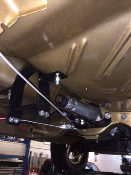

I made one that bolted to the back of the crossmember. It also bolted to the floor for additional support. In the picture below.
I replaced it with this one, which was about 5 lbs lighter and I noticed additional rigidity in the car as well. It ties the frame connectors together as well as driveshaft failure protection.
