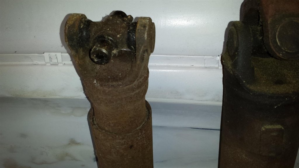

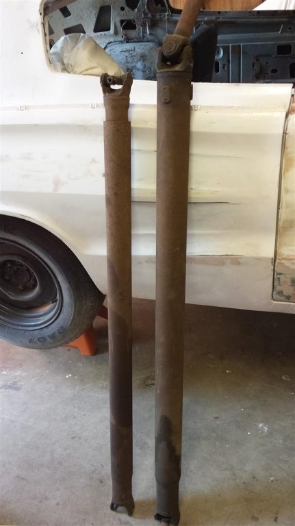

Well, I've never seen one. New to me.
This came in a 318 67 Charger.
But the car had been converted from 3 speed on the tree to 4 speed, 69 dated 383 and a 489 rear by a PO.
So I'm not sure if the shaft is original to the car.
Regardless, I've never seen one.
Were they common? I'm going to shorten another one, maybe from a Diplomat.
This thing looks weak.

I've seen them, but have no specific knowledge where they were used. Probably a vibration dampening thing
Never seen one on a MoPar but plenty of Fords used them in the 60's. By now the rubber is junk so don't even bother using it. What happens is the rubber takes a set and the driveshaft acts like it's bent (vibration). A drive line shop can cut the weld yokes off and put them on a new tube, balance. etc...
These insulated drive shafts were common and mainly came on the 6 cyl, or small blk applications. The idea , was the insulator damped the shift shock to the rear end, and made for a more quite ride. It is not performance, and I would ditch the shaft for a solid tube shaft.
