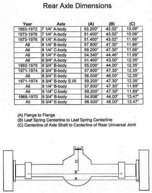

Anybody know offhand if the driveshaft will need to be cut to go from an 8-1/4 to 8-3/4 rear in my 73 charger? If so, how much--any body done it recently that might remember?

If you look at column (C) you can calculate the difference between the 8.25 and 8.75 centerline to U joint centerline. The difference being 0.66" therefore your driveshaft should be shortened by that amout when changing from 8.25 to 8.75. It looks to be very little difference but you definately do not want any bind between the pumkin and the trans.
PS There may be errors in the widths listed on this sheet (A) column

Thanks for this chart Kernel. Been wondering the same thing about my 72 Satellite. Will also be able to verify that my 8 3/4 is correct for 71-74 B bodies. Can you let us know where the chart is from?
Hmmm this chart has been floating around the net for a long time but many dont like it as it is misleading(out and out wrong) on the ABody 8.75 housing length flange to flange.
