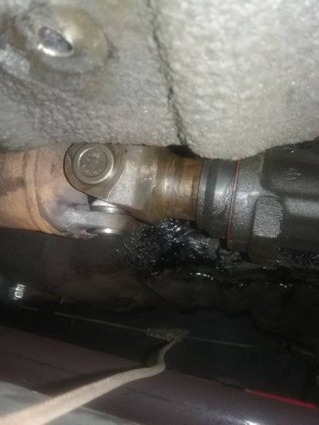

Maybe post a picture of driveshaft in the car with weight on the suspension so guys can advise you if it's to short.

Well, the yoke is sticking out about an inch, which is good with me. It's certainly not 2-5 inches short, as the driveshaft chart would lead me to believe. Not sure what's up with the chart, but my driveshaft is 50.9 inches and fits fine.
Looks like good to go to me

If your driveshaft sits with the yoke 3/4"-1" from bottoming in the transmission, with the car's weight on its wheels it's perfect so don't sweat the charts
