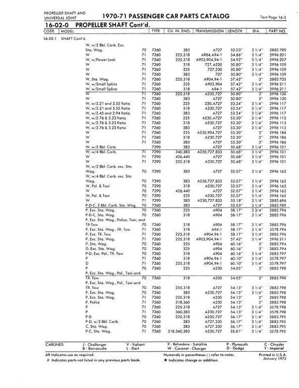

Anyone happen to know the original specs for the driveshaft on 71 charger with a 727 trans and 8.75 rear end? I need to have one made for my car and would like to give the company the specs of the original piece.
ALL THIS LIST is to 8 1/4" and 8 3/4"
