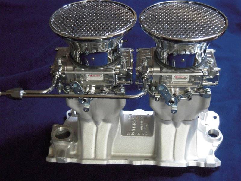

I have an Offenhauser 360 dual quad intake with two 600 cfm Holley carbs with single feeds and the connector tube to the rear bowls. The carbs have the banjo fittings...my question is will a dual feed line work and fill the rear bowls? SEE THE ABOVE PHOTO I found on the web...it’s hard to see if there is an additional adapter fitting for the line.
I'm not familiar with those carbs, but above the label I see a tube going to front and rear bowl.
Also, I suggest you find one of the "dual feed" fuel lines that is adjustable (or make your own). I doubt if the Holley 600's would be perfectly spaced apart on that intake to match a single-pumper dual feed OR a double-pumper dual feed with exactly the correct distance apart. I think I remember seeing and adjustable dual-feed fuel line that had a small fuel pressure gage in it somewhere.
