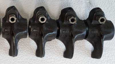

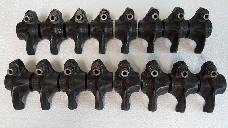

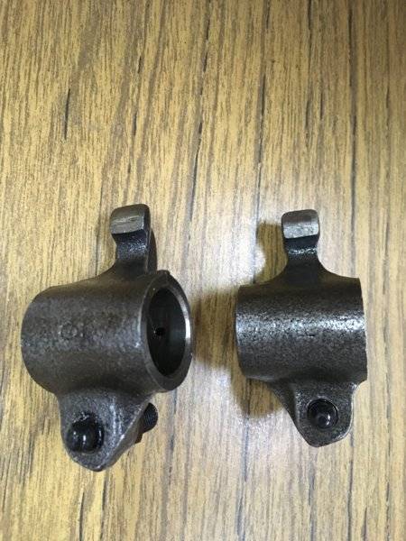

I picked up a set of used Ductile iron adjustable rockers for a Mopar Big Block. Everything about them looks like a crane rocker arm. (minus the name crane cast into the bottom. Does anyone know who mfg these arms? Also,
is there a quick way to tell if they are 1.5 or 1.6 without installing them on an engine?
I have a set of Iskys and they say that. Erson, Crane and most if not all have the name cast in. Yours might be factory original or dealer. The pad surface looks kind of beat up but should be able to be repaired and bushed. I dont think anyone makes these any more. 1.5 or 1.6 ?? You should be able to measure from the adjuster to the tip. I dont know the spec but it is out there.
Isky's have& Crane's have the name. Don't recall about Erson's. Been a while, but I'm pretty sure the factory versions had no markings. My 1.5 ratio Isky's are 1.5" tfrom rocker shaft CL to valve tip center & 1" from shaft CL to pushrod ball center. As for ratio of yours, measure them. Factory would be likely be 1.5 ratio.
These were Ersons. When comparing them to the 1.5 Cranes that I used, they had more lift. So they must have been 1.6

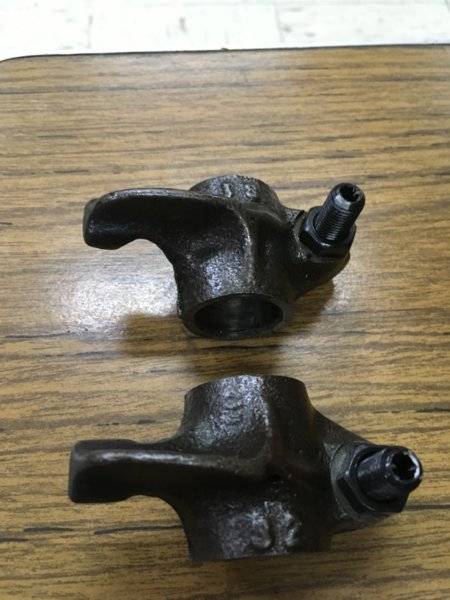

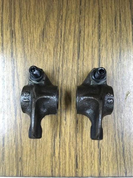

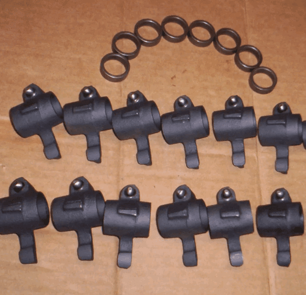

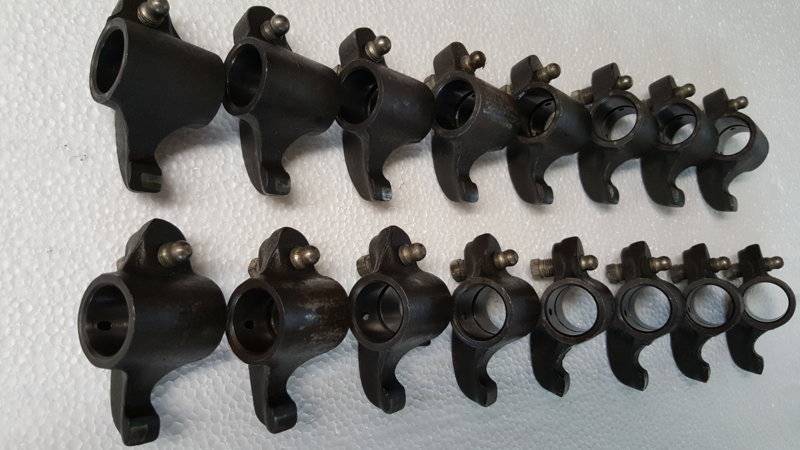

I enlarged one pic. And added your pic. Look very similar and mine had no name either.
Isky's have a hardened pad for valve contact and the name cast into them. Crane have no pad but also have the name cast into them. My guess is there are factory original adjustable rockers. I had a set a long time ago.

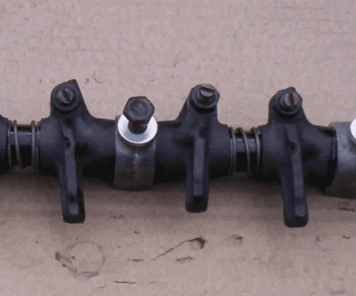

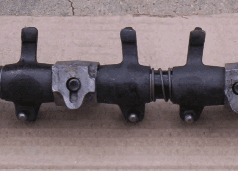

Edumacate me here guys, but what big-blocks (besides the hemi) came from the factory with adjustable rockers?
Early big bocks. They also had seperate aluminum shaft pedestals instead of the cast ones of the later heads. So those motors would have been 413's, 426 wedges, and possibly early low deck big blocks.

Max Wedges used them, not sure about the non HP versions. Also available thru DC in the mid - late '70's.

What would be the easiest way to tell a big block from a small block ductile iron rocker?
