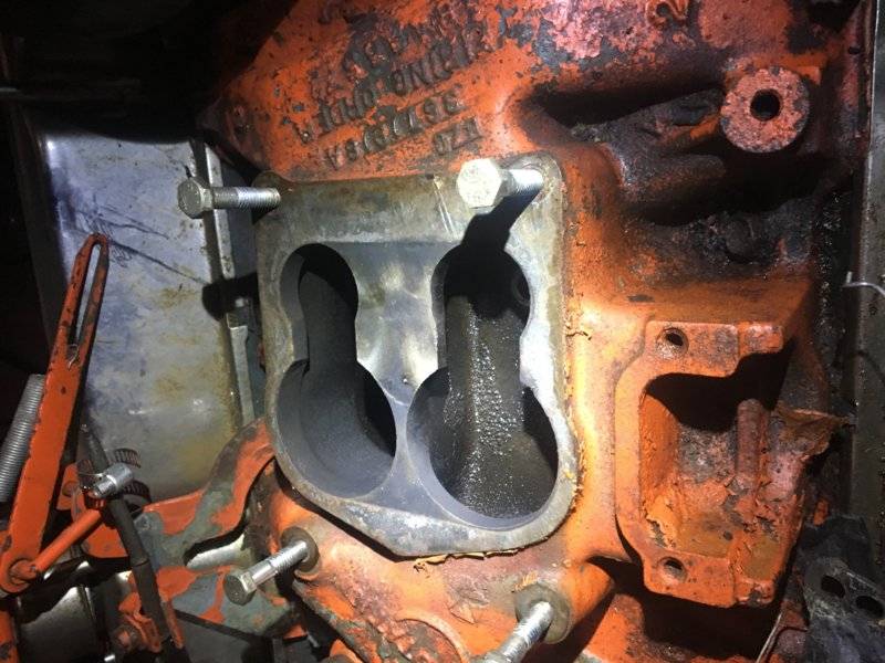

Back with the dumb questions what are the chances that this carb spacer is causing my no idle issue? The intake is spread bore the carb is square bore and the spacer is just an open square. Which correct me if I’m wrong is basically turning my dual plane manifold into a single plane? What do y’all think?

well, i see a couple of issues.
Adapter plate definitely wrong, get at least a 4 hole spacer, square bore or spread to square.
I have had good results with a 1/2 inch 4 hole phenolic adapter, keeps your fuel cold. Even on a spread bore manifold.
i hope you connect the large vacuum port to the brakes or PCV valve?
i also see the vacuum ports plugged for the distributor. you should connect it for your vacuum advance.
Yeah ignore the ports, I disconnected the Pcv hose for the picture and capped off the vac ports to eliminate that from the possible vac leak equation. Power brake is capped off with a bolt.
That carb is dirty. Dirt is your carbs enemy. After cleaning, inside and out, try resetting your timing, Adjust air mixture screws to highest rpm/vacuum. reconnect the vacuum advance, and see how it runs. a lot of times, it's the little things that make all the difference.
I think purplebeeper lined it up correctly with your options. With that said, I can tell you I have run a Holley 600 on my spread bore manifold with the correct open adaptor plate, and it ran just fine, however, the Holley always had a problem with the floats sticking open. Now, I am running the large thermoquad and once I got it dialed in, it runs great, idles great, and runs wide open great. Only issue with thermoquad is trying to find one that doesn't have worn out throttle rods.

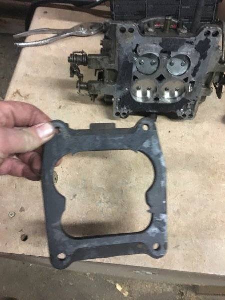

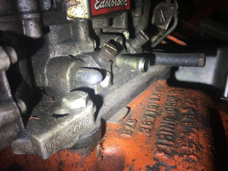

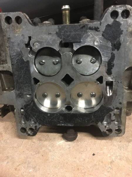

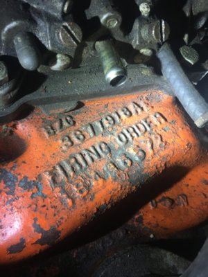

Had a few seconds to get the carb off and get a better view, needless to say I’m not sure what the previous owners had in mind with this setup
C97ADEB9-79F2-4D20-892D-BAEE6DEB4F28.jpeg BD8417FD-2C0F-48EF-B41B-F6ED909EE0A7.jpeg BBA0D4D4-9699-4C22-A129-9335931DE3D3.jpeg
So did you do the last rebuild, or two?
I did. But I’m not afraid t call my self a rook at this engine stuff. I didn’t even realize it was a spacer until just the other day when I looked up the casting number of the manifold and saw that it should be a dual plane not a single plane. As it appeared when I pulled the carb off the first two times.
