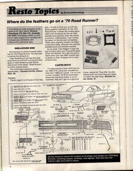

Dust trail Correct placement 1970 RR

Center of the scoop to 1/4" above wheel well. The dust trail. Or even with the Roadrunner emblem which is just above center of the scoop.
