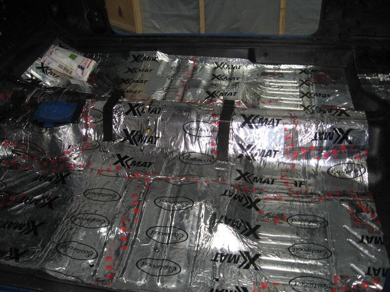

bought X mat from East wood. After much research it seemed to be the best. The foil will cut you if not care full. LOL. Got the roof liner made for roof and hood application's. No problem with covering the tunnel. Every thing fit fine with the console. I was afraid of the thickness also. But left it off where the floor shifter came through. So the boot would seat well.
Drove the car yesterday and it is quiet.

The X mat has no smell. Think it is butyl also. It sticks well. No issue with fitting console after installing carpet. That was my biggest concern was it going to inter fear with fitment.
