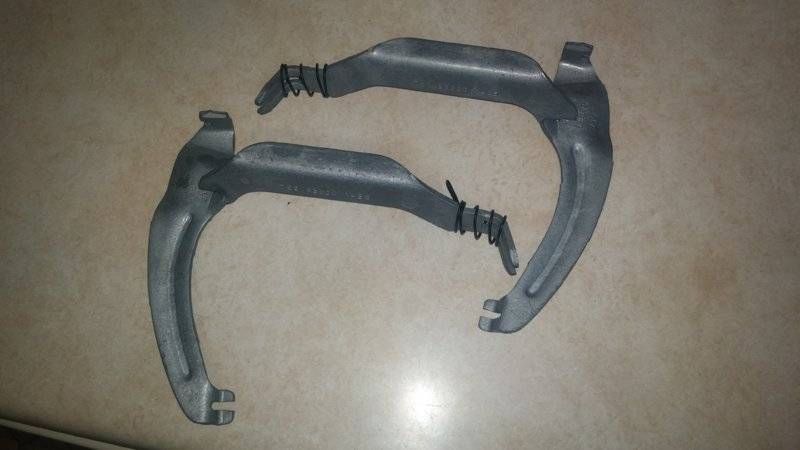

I'm building the rear brakes up on my '63 with a 11x2-1/2" drum set I found here on the site. My problem is the E-brake actuating lever is from a newer set that uses different shoes. I'm looking for the ones, left & right side, that have the pivot pin, spring washer, and C-clip. I believe the Bendix part #'s are 323227-L, & 323228-R. Are these available anywhere yet, or only NOS from ? I'll probably post in the WTB with those #s, Thanks for any input on this...

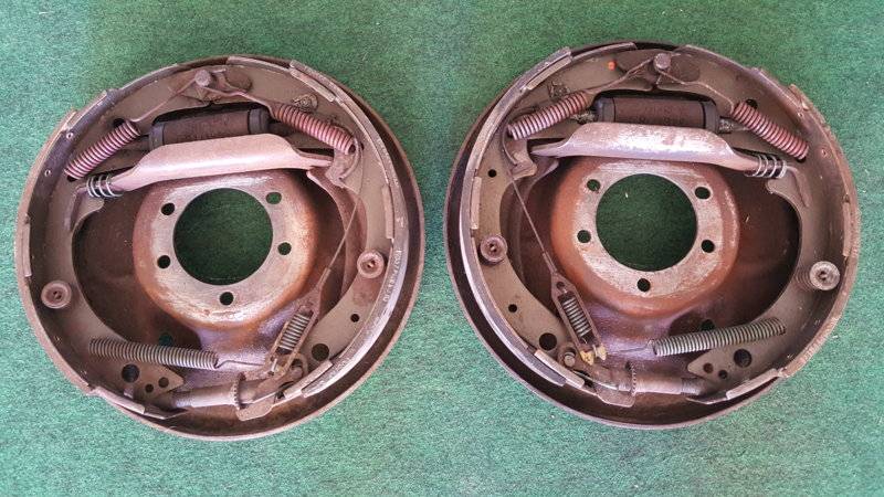

I have a set of 11"x 2" not 2 1/2". Wonder if they would work? I don't know what year they're off of.

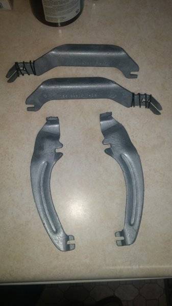

I think the e-brake parts are the same. That looks like a decent complete set you have. I only need the levers, as I think the center bars are the same. Here's what I have, and these are for shoes with a slot for the top pivot. I would be interested in the parts if you're breaking the set up, or trading the levers ?
THANKS out to KK for coming through with the needed parts ! These will complete the rear assemblies for the '63...
