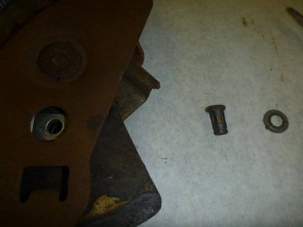

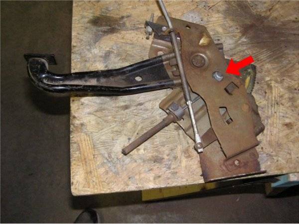

Well, I'm at the point where I am installing the E-Brake assembly and tried to put in the cable, but found out that I need the "pin" that holds the end of the cable to inside of the assembly
( I saw someone's picture of an assembly ( I did not take a picture of mine) and added the red arrow to show what I mean) only to find out I do not have it. Also when we push the pedal down it does engage the "ratchet" to lock the pedal. We first thought that there was an internal spring inside, but I am kind of thinking the spring on the handle was the spring that holds the teeth in place, am I correct? Does anyone know where to get the "pin"
I'm not sure where to get the "pin" & I'd have to take a look at mine to be sure, but you might be able to just make one.
The spring on the handle is what makes the e-brake "ratchet" & lock in place. Without the spring, you have to push the handle forward to get it to work.
Try eBay....saw some of this stuff on there.
Thanks Guys, that helps. Not sure why they are not repopped.
Tried e-bay, with no luck so far. Tried a few different descriptions.
Must have been purchased, saw it yesterday. I looked and found a complete ebrake, salvage it?
Mopar 66-70 Dodge Plymouth B Body Parking Brake Mechanism
Thanks Red, but was just looking for the pin only. My body guy machined one and made it work.
Thanks
