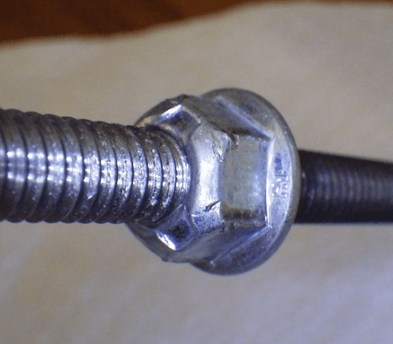

FWIW, my SS Inlines came with a "3-hit automation top lock" locknut for adjusting at the equalizer. Prevailing torque was excessive and galled up the threads as you can see in this picture.......
Inline did nothing for me as it was "beyond our warranty period". So, don't buy too early and let them sit.
Otherwise, they are fine.
