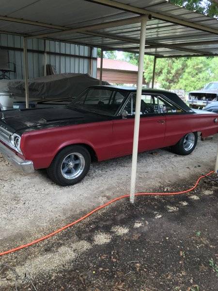

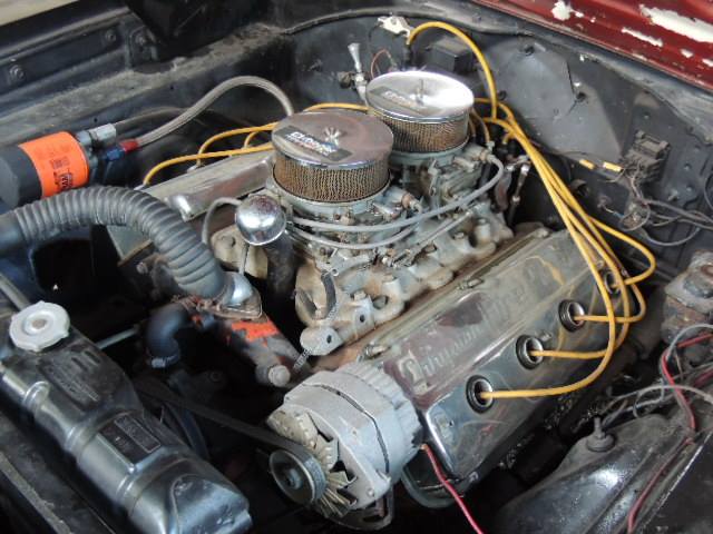

For years I've been trying to decide the best way to put a standard transmission(4, 5 or 6 speed) behind my '58 Imperial 392. Recently I've read about the NV3500 being an almost bolt in application. I already have a 727 with adapter in my '67 Belvedere. I'm worried about gear ratios. The car already has a 4.56 gear set in the rear end. I read where the NV3500 first gear is 4.04. Would this transmission work with the gears I'm running and still be drive able.View attachment 1930260View attachment 1930261
